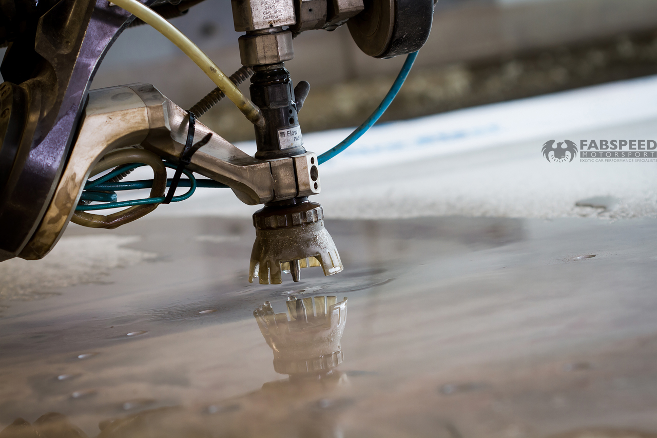

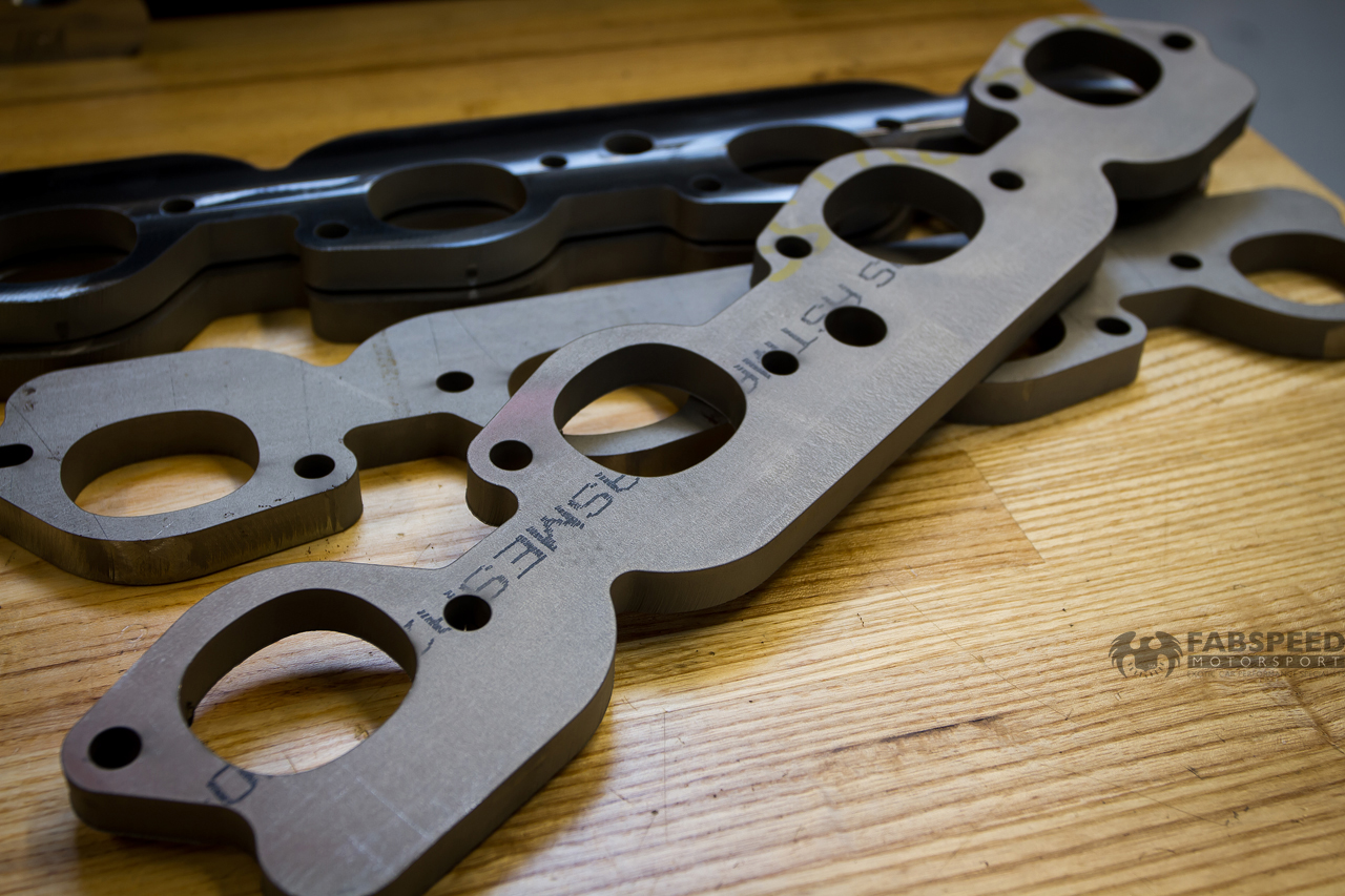

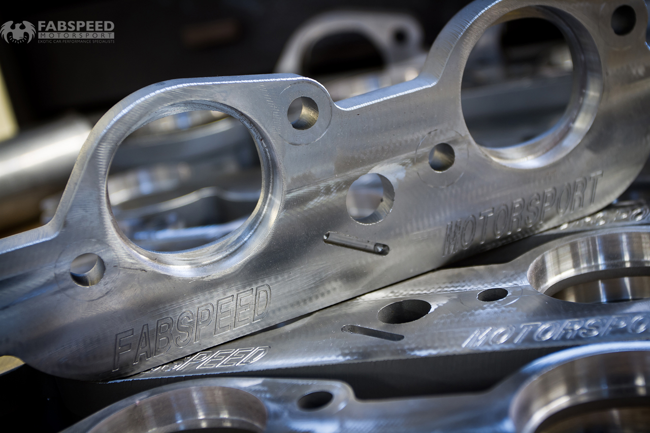

First, the main block flanges are cut out of solid stainless steel on the water jet machine.

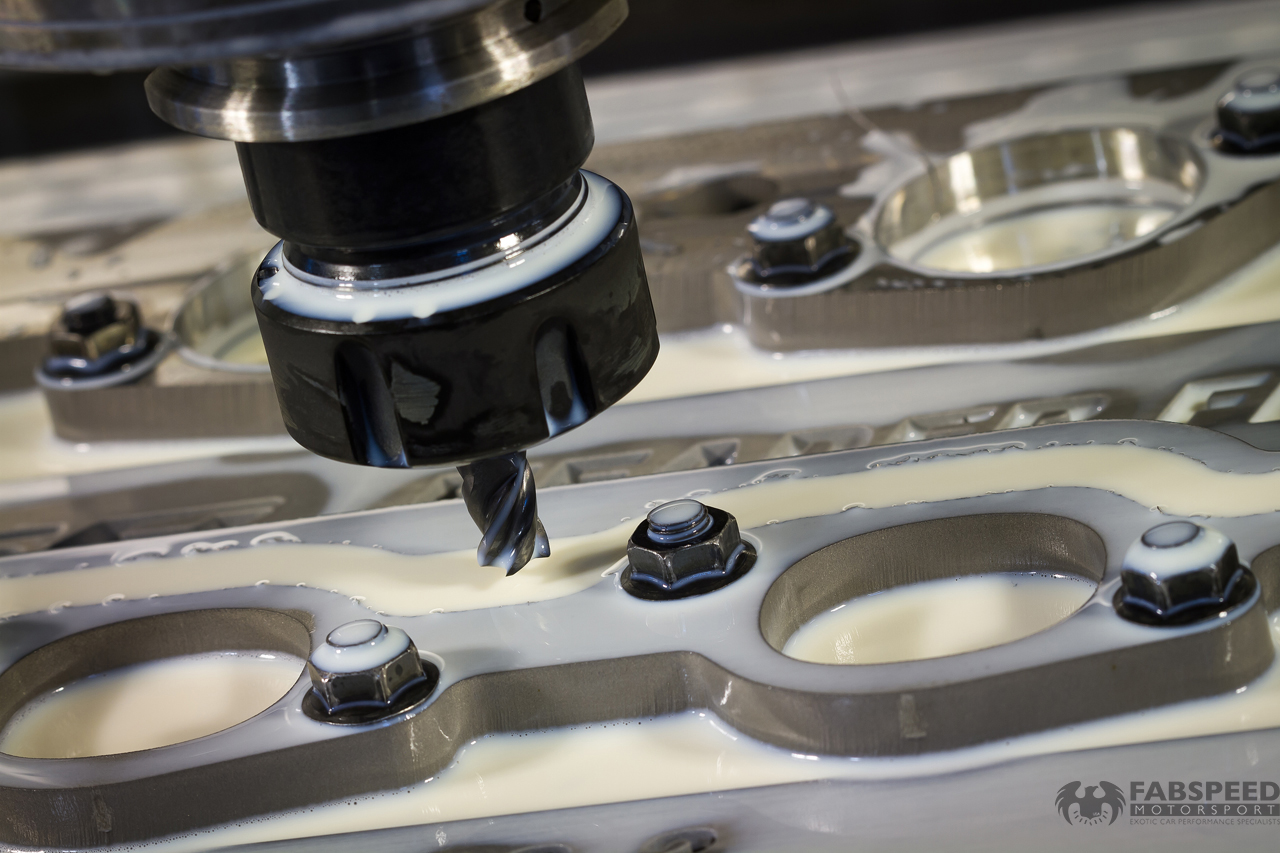

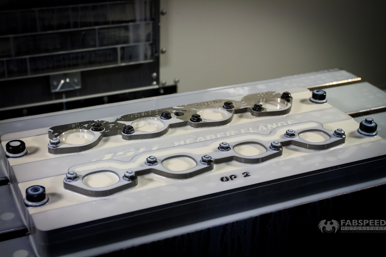

These blank flanges are then fixtured into the CNC machine and milled out.

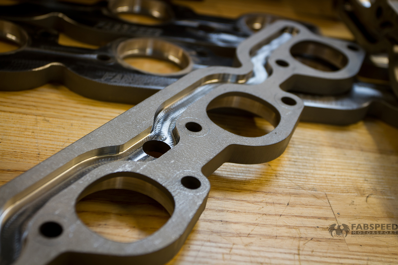

The openings are countersunk to receive the header tubes, and the faces of the flange receive the required air injection channel and various markings.

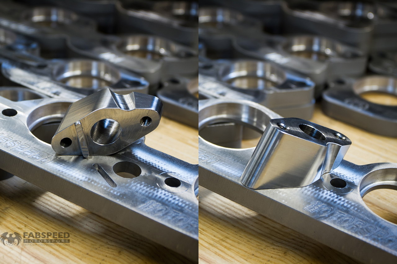

Air injection ports are then test-fitted on to the flanges.

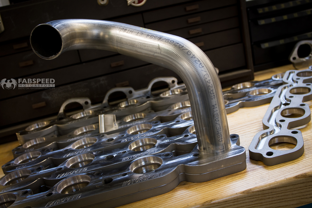

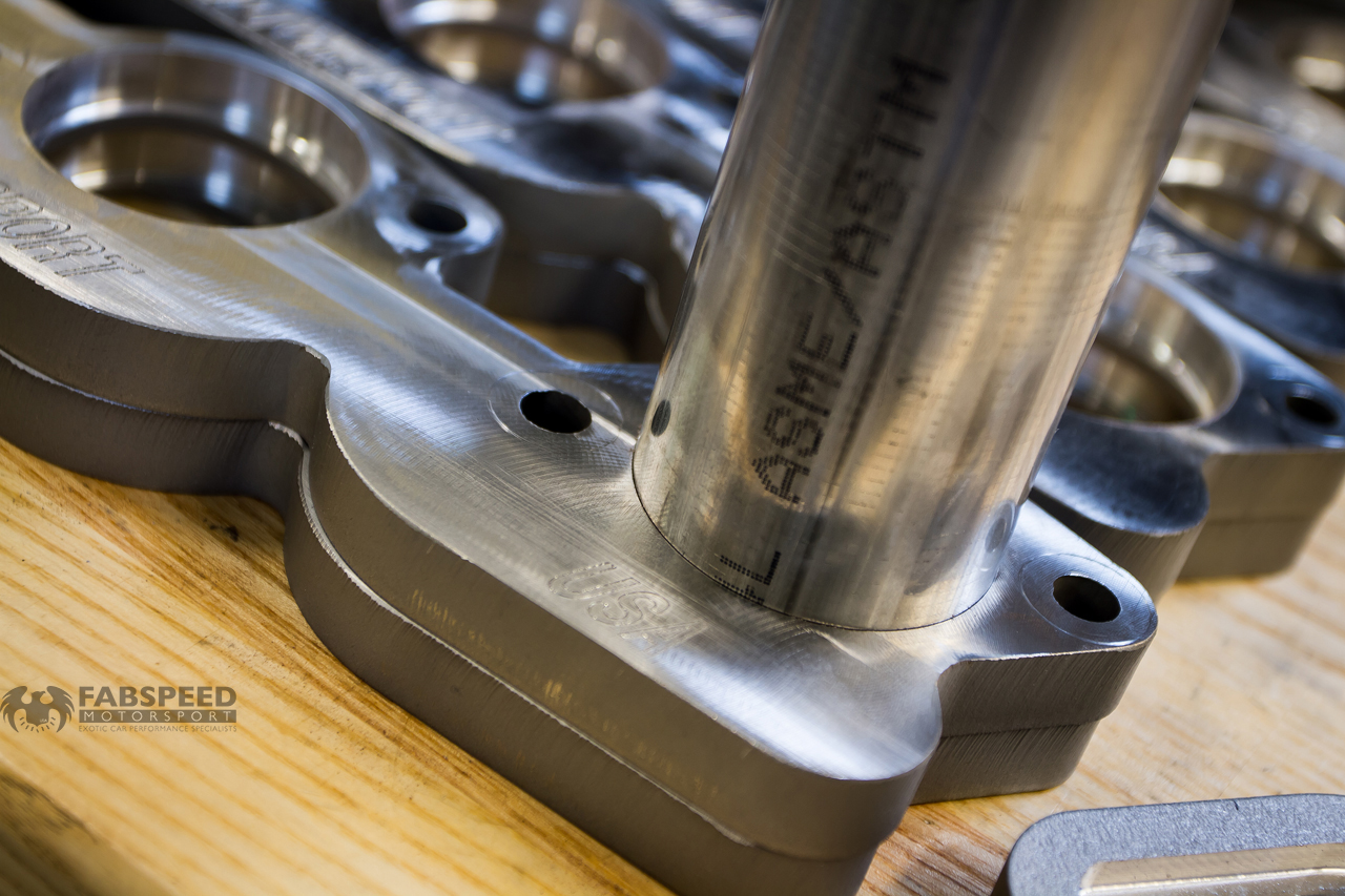

One-piece mandrel-bent header tubes (made in-house on our Unison bender) are inserted into the new flanges to test for a perfectly flush fit.
Once the fit has been verified, they will then move over to welding where they will be assembled, and then given a final polished finish.
